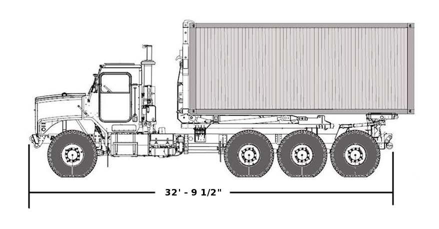

Would anyone happen to have basic dimensions on the 16.5 ton LHS?
__________________________________________________________________________________________________
At Gino's recommendation I scaled out the entire vehicle based on the container being 20' long.
CORRECTION: I finally found the overall length posted in an OSHKOSH publication. Their published figure is 33 feet, 6 inches measured to the rear end of the "tilt-load" equipment!
For the time being I am not going to rely on this overall vehicle length measurement being exactly correct. I don't completely trust it just yet! I want to find the same data printed somewhere else before I trust my attempts to scale this drawing.
No measurements, but by scaling this up to 1/35, you should be able to work them out pretty easily, esp. knowing that the container is 20' long.
You should also be able to extrapolate the numbers by comparing it to this one too.
I also found this. It looks like it has a different wheel spacing and something else between the cab and load though.

Posted: Sunday, November 13, 2016 - 11:31 PM UTC
Well you are right Gino, having a 20' container in the drawing SHOULD make it fairly easy to scale up! Sometimes I can be rather stupid, woods for the trees and all that!
Do not know what that bottom drawing might be, an early design prototype perhaps or a product for the European market???
