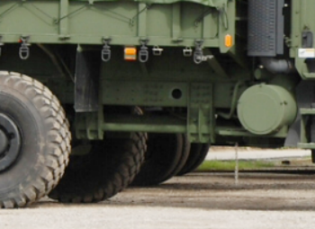

Mk28 Extended Frame MTVR with winch:
(All photos this post by navymailman )
I put a call into Oshkosh and was lucky enough to find someone willing to take a moment to discuss this. It was confirmed that these are considered torsion bars in the parts manual - used for the purpose of resisting frame twisting and therefore reducing the chance of wheel hop. At this time we are still not sure if these bars are actively connected to the suspension or connected only to the frame and used simply to reduce the chance of frame twist.

In the right side shot, it does look like the torsion bar extends forward of the front frame mount. Interesting.
It does, on both sides. There is another mounting bracket behind the fuel tank and the boarding steps.

Good to know. So the torsion bars do not connect to the front suspension at all. They are there to add strength to the extra long frame so it doesn't buckle or twist under a load. Is that correct?

Posted: Tuesday, February 28, 2017 - 12:40 AM UTC
That is my understanding.

Posted: Tuesday, February 28, 2017 - 12:51 AM UTC
Guys, having extensive knowledge of the TAK-4 suspension I can say that this torsion bar set up in not connected to either the front or the rear suspensions. These were added to counter the torsional twisting created by the longer frame. Very few TAK-4 suspensions in military use torsion bar set up, almost all are coil over springs.
